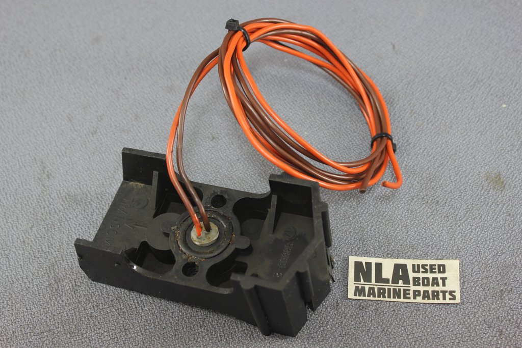

Tengo un crucero con pata Yanmar la cual tengo excelente proteccion catodica debido a un Mercatode colocado que me ha protegido la pata de manera espectacular Saco el barco cada año y trabajan perfectamente los anodos.

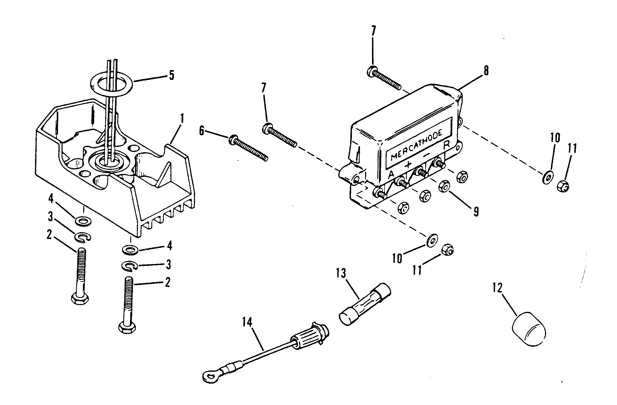

Esto encontré en la página de Mercury:
QUESTION:
What is a MerCathode and what does it do?
ANSWER:
The Mercury Precision MerCathode system provides automatic protection against galvanic corrosion. It is a solid-state device that operates off a boat's 12-volt battery and provides protection by impressing a reverse blocking current that stops the destructive flow of galvanic currents. If your power package does not come already equipped with a MerCathode system, Mercury strongly recommends that you install one, particularly if your boat is equipped with a stainless steel propeller or other submerged stainless steel hardware. The MerCathode should be tested annually by an authorized dealer for proper operation.

cátodo
cátodo
mercathodo
mercathodo
